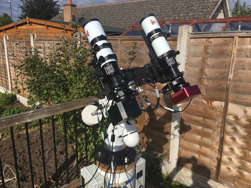

I was hoping to have more time/success with my twin scope set up, so I've been making some improvements. I've added a 4 port USB 3 hub and cable to replace 4 separate USB 2 cables. The theory being USB 3 cables should be better quality. First impressions look good, but time will tell.
Also purchased a new camera, a second hand Atik 383L+ as this will match the sensor in the Moravian G2-8200, which the QHY8L didn't when I used that. That should simplify the processing of the images and hopefully give a better result. To this I've added a ZWO mini EFW.
The set up will be:
Moravian - LRGB filters
Atik - L, Ha, Hb Oiii, Sii filters
This should allow me to maximise my imaging time.
Might swap the filters around a bit, might make sense to split up the RGB to allow LRGB imaging only to be set up.
Here's the new set up:
Looking forward to some clear skies.
