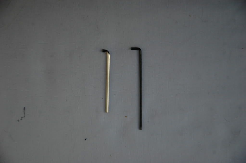

A good Video as usual. The collimation for the focuser is a pain with the obscured screws underneath the focus wheel assembly. It's the same on the 300 PDS. I ended up grinding a couple of Allen keys down.
