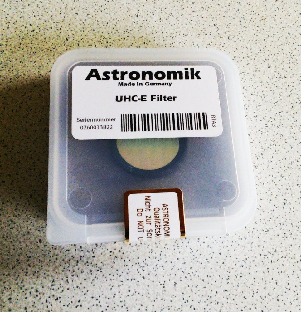

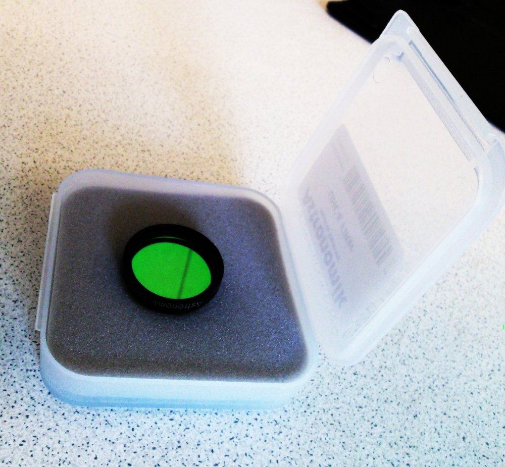

The Astronomik UHC-E comes complete with its own protective plastic case, there are the usual male and female threads and there is a slight ‘crown’ on one side of the filter housing. Astronomik claim a 94% transmission with a range of 480nm to 525nm and 645nm plus. First impressions are that it is indeed less aggressive and has a better transmission percentage than the similar Baader UHC-S. Both filters supposedly work well with smaller apertures up to and around 125mm. Looking through it by hand held up to a light source it has a very nice turquoise/blue tint. It looks very well made and I assumed the filter thread would be M28.5x0.6 as it seemed to suggest this on their site.
